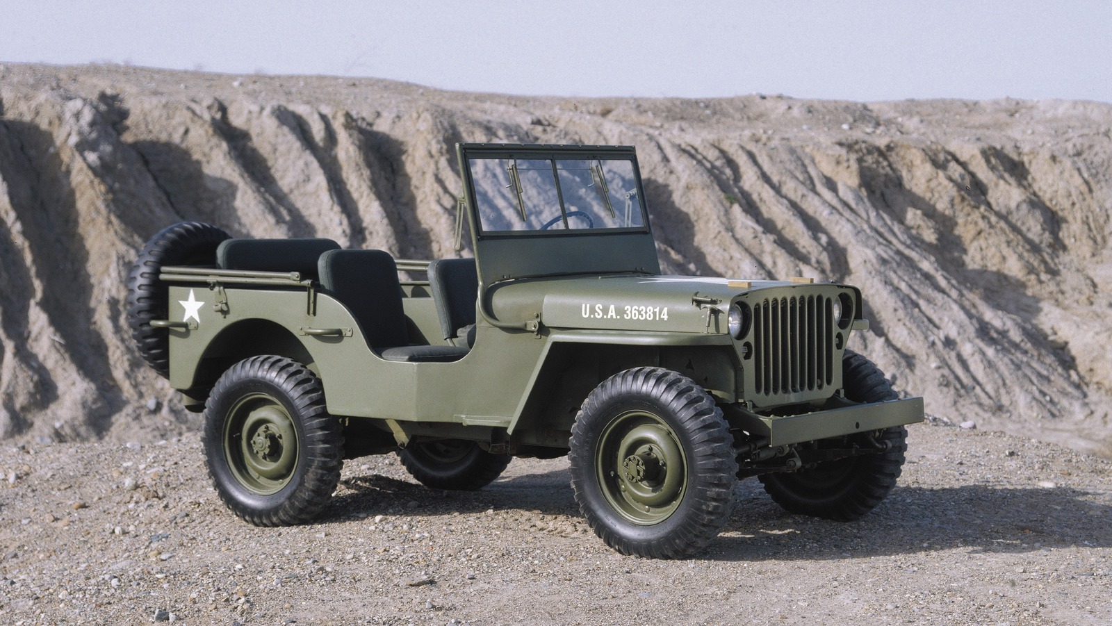

It's only metal, you could drill some holes. Or if you plan to never pull on them, just stick em on! Thumbs Up
Seriously though, I'm not sure when the cross member changed, but they haven't been fitted for a long long time. Not even sure they have ever been on a 90/110.
They have an interesting story..... they shouldn't be on the back really, as they are completely useless there.
The original Land Rover, centre steer was built on a Jeep chassis and the Wilks had a WW2 Jeep they used on the farm as inspiration for the Land Rover.
If you look at an MB Jeep, you'll find these handles in the correct location (to be used by Squaddies to man handle the vehicle when stuck):
Complete with matching bolt holes & dimensions.
You can almost imagine the Rover boys having a big piles of Jeep bits left over and someone grabbing them and saying "hey, why don't we stick them on the back!" Mr. Green
Either that or it was a premonition that Land Rover owners would spend a great deal of time under the vehicle and would require a handle to pull themselves out from under the vehicle Rolling with laughter

Wow! And there was I thinking that I shouldn’t post such a trivial post. The someone comes along and answers a long standing question.
Thank you, really interesting

The Jeep handles are different to even the earliest LR handles.
Every standard Defender rear cross-member has been drilled (or rather punched) to take grab handles or military bumperettes right up the the end of production in 2016. The only thing that gets in the way are the fasteners for the seat belt reinforcing brackets for the forward facing rearmost seats.
