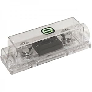

After several home made installations (spot lights, VHF radio, Working ligth, Trailer brake control. Fridge and trailer battery charger and other things, the battery box looks like a spaghetti with all the fuses around. So I decide to put in order all the things.
Finally I bought teh following items from Amazon in USA
ANL Megafuse box with a 100A fuse for all the additions

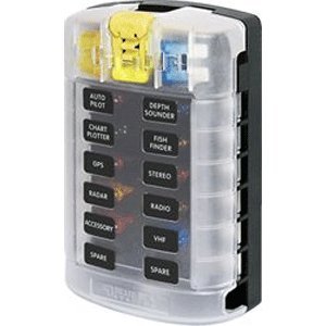

This fuse block for 100A input and 30A max in each output for all the things

Hi Eduardo, the second fuse box is a Blue Sea 12 gang fuse box with common negative bus bars and two banks of 6 fuses. Yes it is a good fuse box Thumbs Up
You will find that it is actually rated at 100 Amps per bank of 6 fuses, 30 amps per fuse.

The two banks of fuses have separate positive terminals which IIRC can either be linked together and have one big positive feed wire or you could use separate wire from battery to each gang of fuses.
If you want too you could incorporate an inline mega fuse 100 amps or less for each bank of fuses.
Might be sensible to balance the loads on each bank. i.e. if you have say four large loads of 20-30 amps and six 5 amp or less loads you wire it so that each bank of fuses have two large loads of 20-30 amps and three 5 amp or less loads with a spare fuse per bank. Hope that makes sense.
Position the fuse box so that you have access with batteries in. Razz
The auxiliary fuse box on our red 110 is in main battery box. That was fine until installed larger batteries and second winch. Now I really should reposition it as need to remove battery to get to fuse box. Embarassed Ho humm thats another job on the list.
So some forward planning and foresight on possible future alterations. Isn't hindsight wonderful?

May be I have a different version (PN 5029). Mine have just one positive distribution bus instead the 2 that you mentioning. Also this model do not have the negative bus. Anyway thanks for your advices.

Fuse box with lid on
Showing two banks of fuse and common negative bus bar
Brendan
