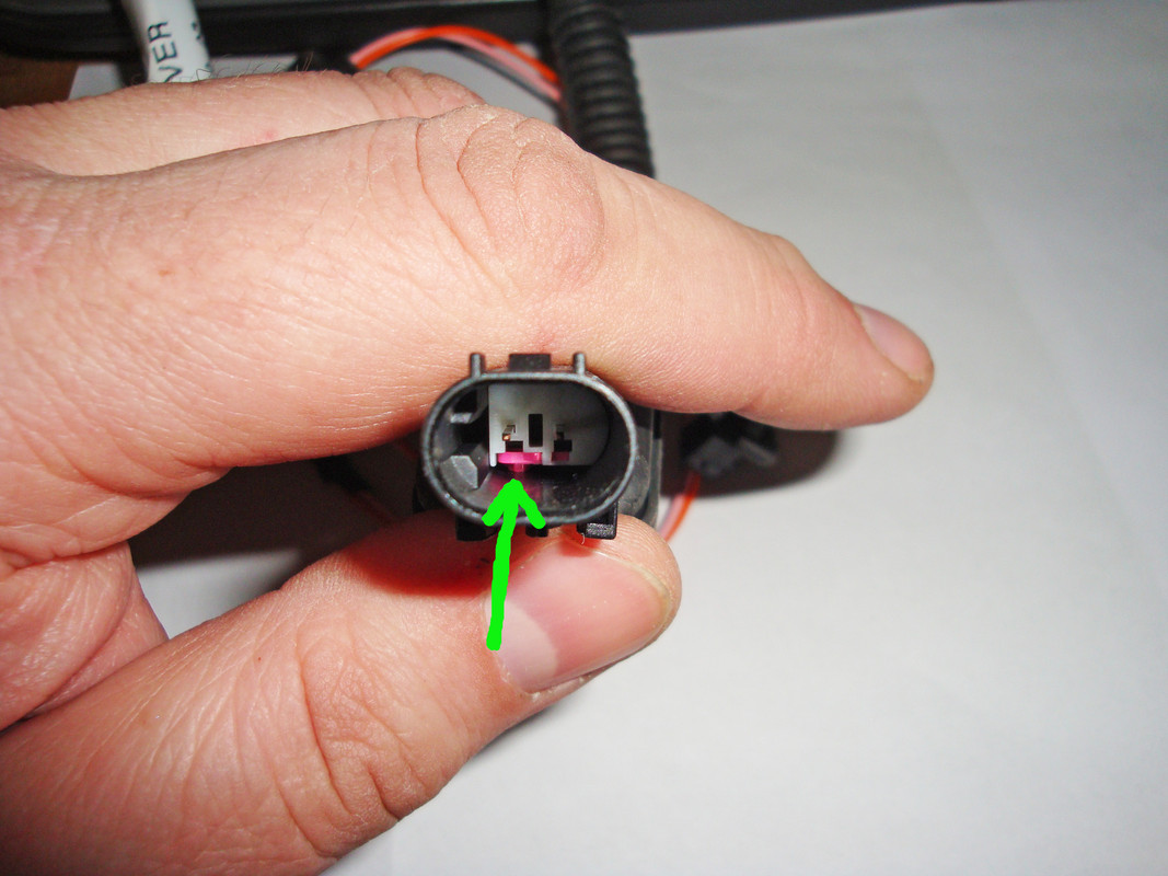

Yes, the pink lock needs moving to the right, I use a jeweller's screwdriver to do this.
Locked -

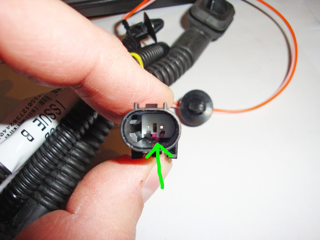

Unlocked -

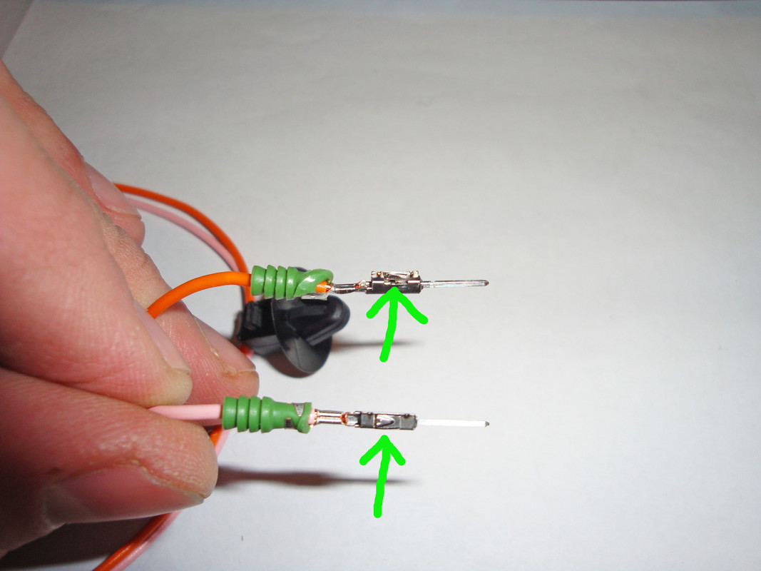

Release the terminals by inserting a terminal tool in the hole below them, to depress the locking tang on their bottom -
I use one of these -
. Paul.
