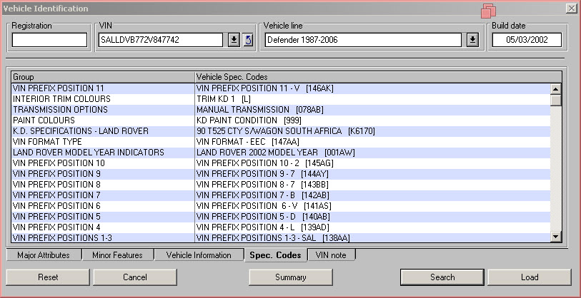

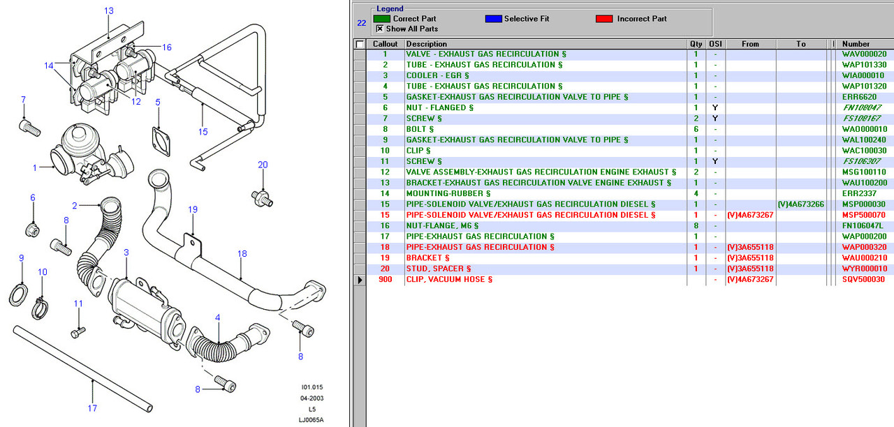

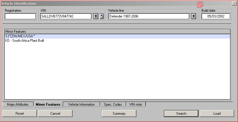

mturri
Member Since: 13 Jul 2010
Location: All over
Posts: 33
 2006 Defender 110 Td5 CSW Bonatti Grey
Nothing in Microcat. EGR level and emission directive it conforms to would typically be listed under minor features and spec codes respectively.
However, a few levels down in the EGR parts section, part applicability appears to indicate that is fully Euro 3 compliant, that is, cooled EGR etc. Take this with a pinch of salt though...
