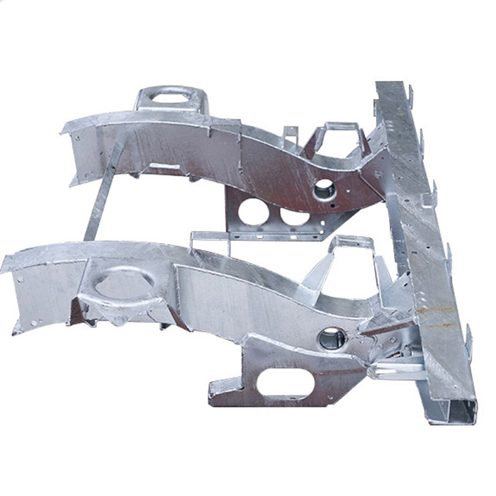

As you might have guessed it doesnt fit Smile The downpipes fit nicely. They come out towards the rear of the xfer box. The problem is that the centre box is way too long, probably needs to be half a long. The other issues is that the rear pipe fouls the brackets which hang down under the chassis. see pic.

That’s a td5 fuel tank chassis, you’ll have the exhaust for a 90 which tank is under the seat.
You could probably get a td5 rear exhaust piece? QRZ M8VPF

thanks greeni. worth a try. i need to eyeball a few and maybe measure up. The td5 chassis is a bit different to mine. mine has that tank bracket which sticks out towards the wheel, the td5 ones ive seen on google are just vertical if you see what i mean.
