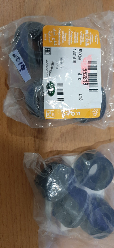

..here is the guilty one..im not sure how long these will last considering that they are so soft and i can squeeze them by hand easy..

Shock absorber bushings? Question

..yes..upper pair was gone, so i replaced all at same time..but im surprised after i realized how soft these are..

I've got replacement shock absorber bushings, both upper and lower, for all 4 shocks. Hopefully this will solve my clunking issues as well. Thumbs Up

just to make sure it's the correct part you are talking about... The ones in the photo (552819) are for the anti-roll-bar connections. The correct part for your shock absorbers is 552818. They should be quite a bit firmer.
Here you can find the part numbers for the shock absorber bushes:
https://www.advancedfactors.co.uk/ekmps/sh...shocks.png
