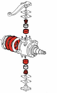

In order to cure a negative caster angle on the front left, the wheel alignment specialist recommended we fit one of these caster sleeves, made by SPC: https://www.spcalignment.com/instructions/88901-INS_WEB.pdf

I've not seen these before, are the an alternative to caster correction bushes? 2007 110 TDCi Station Wagon XS

Indeed.
Whereas bushes must be installed in a set, this allows you to tweak the castor on one side of the axle, and this company makes them in small increments, from 1.2 to 2.2 degrees. --
