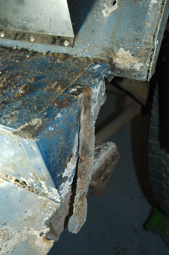

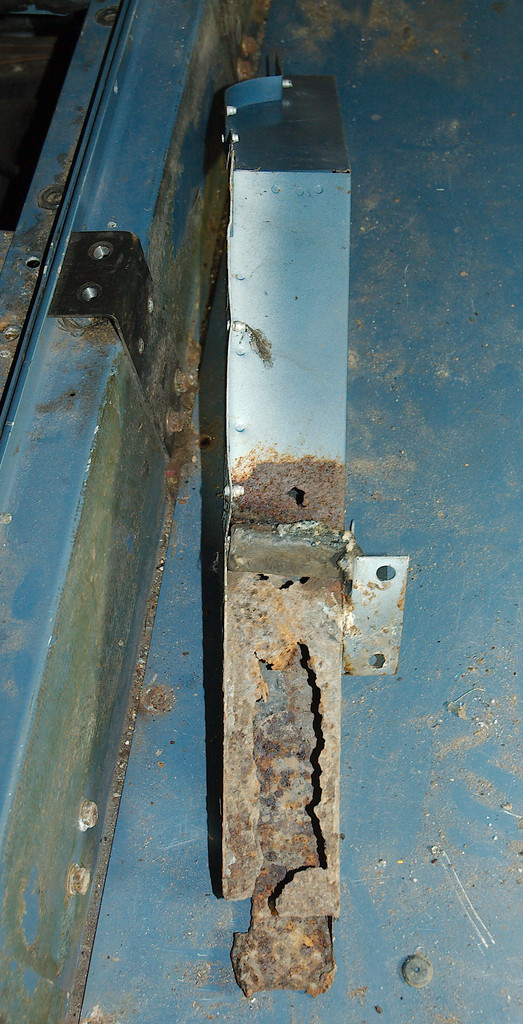

Sorry for the delay in getting back to you. As my 110 currently consists of a chassis sitting on the garage floor waiting to be painted - I'll be taking the 110 apart ![]() There wasn't a lot of metal left on either side - believe it or not this was the better side of the two! ![]() Click image to enlarge ![]() Click image to enlarge 2005 Td5 90 XS 1989 V8 110 CSW |
excossack Member Since: 22 Feb 2012 Location: North West Posts: 6021 ![]() ![]() ![]() |
The better side...eeeeek! 1999 Defender TD5 110
