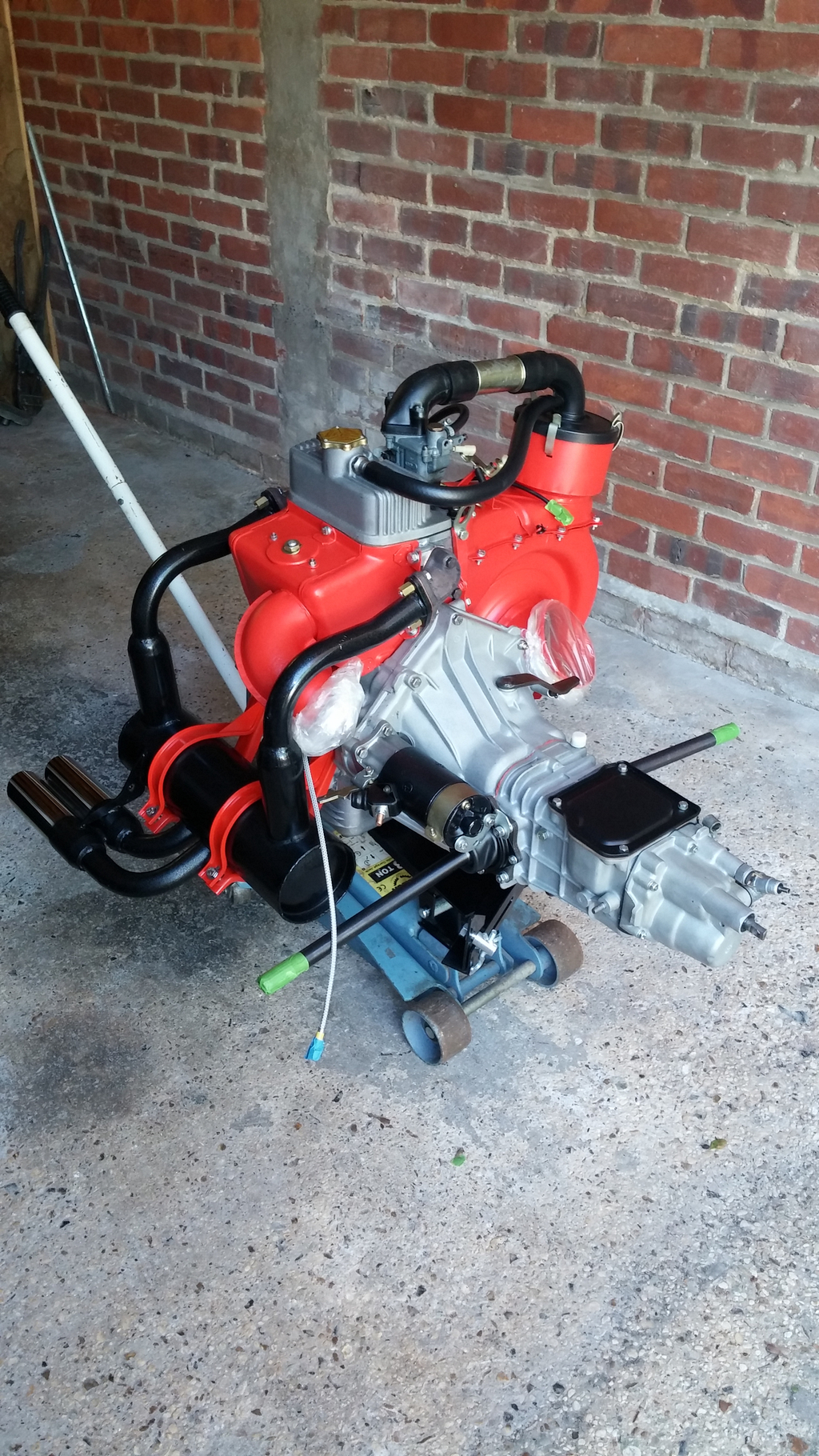

I picked up a transmission jack adapter off eBay for working on my classic fiat 500...
https://www.ebay.de/itm/172516239837
It was perfect for pulling out and replacing the engine and gearbox on that in one go...
So it would handle a Defender gearbox ok.
Cheers, Steve

^ ^ ^ That is a piece of art Thumbs Up Clayton.
