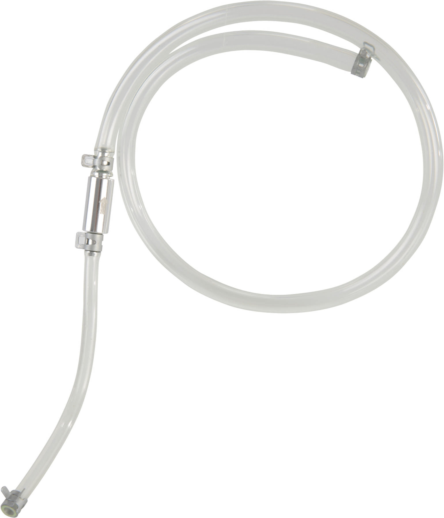

Thanks for this Agentmulder. One wee add...I used a bleed pipe with a valve in it,: ![]() Click image to enlarge This made it a one-man job (used the same pipe for bleeding brakes on the Defender last year). The "bleed nipple" is a plastic valve as noted above, it fits a 13mm spanner. You only have to open 1 turn, and close gently, it would be easy to damage it... Because I had the pipe with the valve, I only had to open it once, and then close at the end. Also just to note, once you remove pressure from the clutch, the pedal no longer rises on it's own. I found 3 pumps (by hand) was enough to almost empty the fluid reservoir, so every 3 pumps I topped up the fluid in the reservoir. I did this 6 times and that flushed the pipework sufficiently. Of the half litre of fluid, I probably only used 60% Defender "Puma" 2.4 110 County Utility (possibly the last of the 2.4's) |
