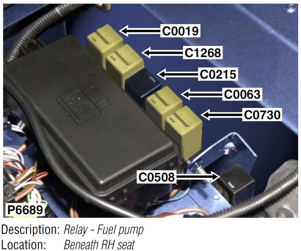

Check condition of fuel pump relay (C0730 on below snap).
Ran into same scenario, relay & socket had partially melted, additional resistance starved fuel pump so loss of power and the rest of it.
Had to reterminate socket and obviously replace relay.
The AC relay on the left side (C0019) is the same type so a straight swap for troubleshooting purposes.
If no obvious power issues then fuel pump becomes prime suspect.
Fuel pressure regulator also possible culprit though any issues tend to be there all the time, plus fuel leakage from around it is usually a tale teller.
Mechanically assessing fuel pressure is another way to troubleshoot fuel delivery issues, whether FPR or fuel pump originated.
See here https://www.landyzone.co.uk/land-rover/dev...re.125166/

FPR done and unfortunately still won’t start.
My relays don’t look like those in the picture at all, I only have 3 there, two yellow, on black.
Not sure what my next steps are now, I guess it could still be the fuel pump. So maybe I have to bite the bullet and cut the hole in the back to have a look.
