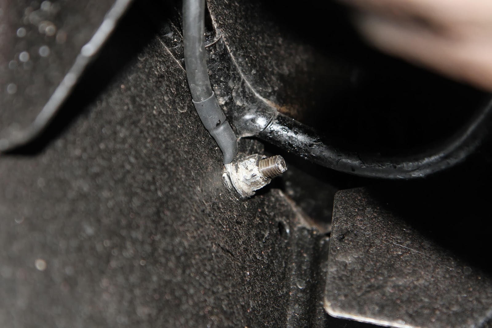

I am working on fitting auxiliary power sockets in the back of my Defender, just behind the cubby-box.
In order supply a negative feed to my power sockets, I was intending to fit this :
just there, by placing it tightened just below the nut located on the top of the negative terminal.
But I just realize that I was a bit too optimistic Big Cry The bolt is far too short and it seems not easy to replace it by a longer one.
Would someone have an idea of a way to connect my negative wires directly to the battery negative terminal, without changing the terminal itself ?
Or, alternatively, which good earth point would you recommend (near the cubby-box or in the battery box), considering that I don't want to drill anything ?
Thanks in advance !

Use a bulkhead lip bolt just behind the cubby rear below, it is a steel lip with steel bolt.
That is a good earth but may need a bit of paint removing for excellent contact.
I used this for by Amp earth and that is nearly 50A send really needs a good earth!

So... if you follow the battery earth cable out of the seat box, and under the car, it bolts to the chassis rail.
I added my earth connector (for accessories) to that point. There is (on a 2011) a 110mm bolt right thru the chassis (just rearward of the fuel cooler), with a couple of earthing straps there...you can just add yours... job done.
