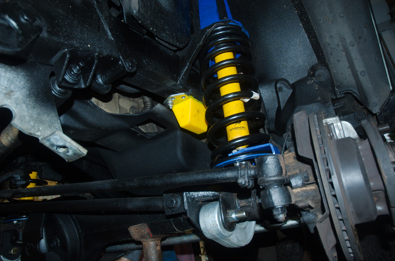

I can't find a particular close up picture of the front after the Sumo kit was fitted, but you roughly see the stance on the Welsh hill side:

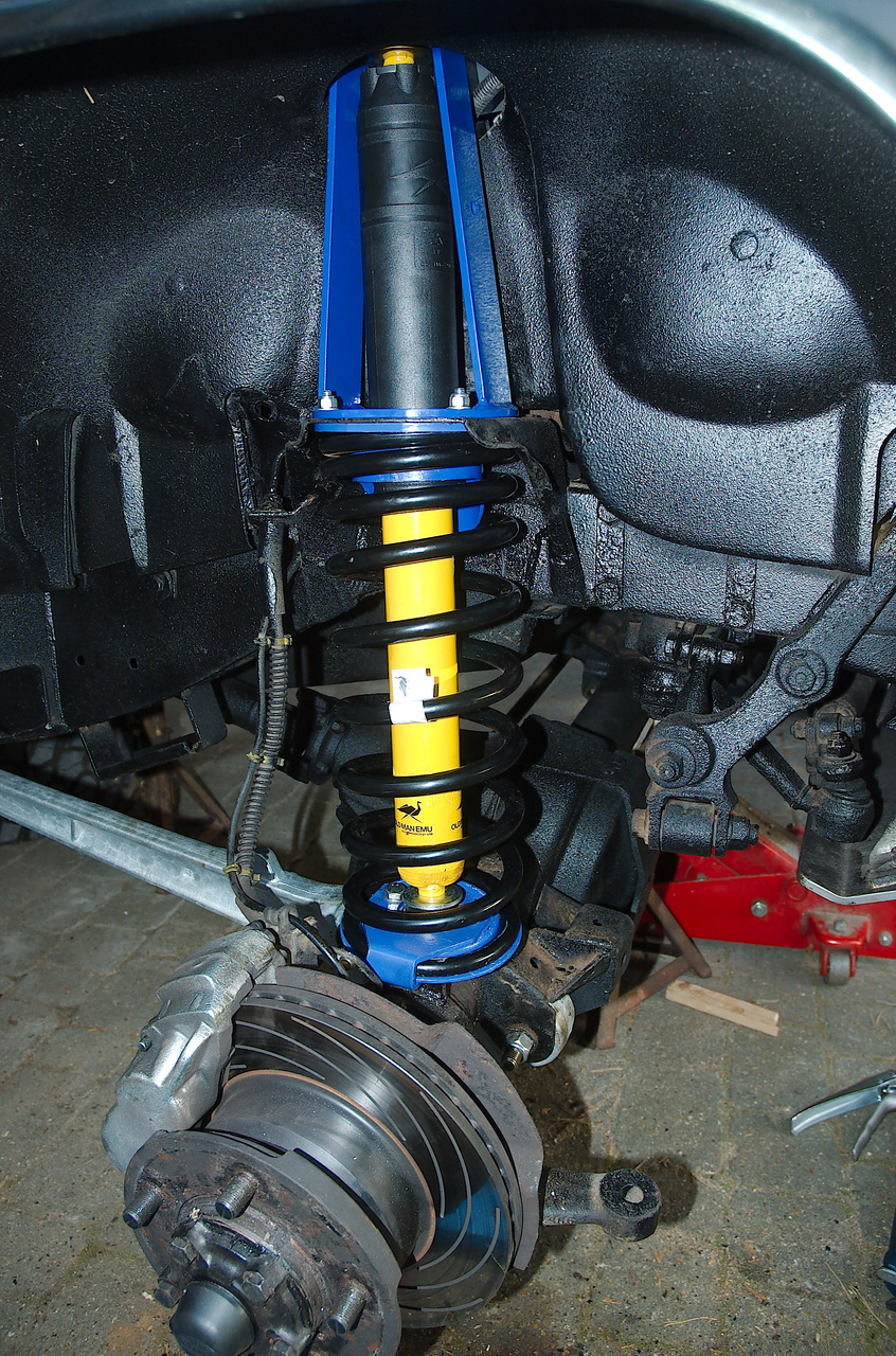

Prior to this, I have the following where the radius arms have been fitted and rear drag link, but not the front one at this point.
When we talk about the Panhard rod, we're talking about the lower of those two front arms, which keeps the axle from lateral movement right? The one on the right of this picture:
That is one which I didn't change/check/losen, I wonder if that is the problem as you say "I Like Old Skool", I'll check that at the weekend - thanks for the tip.

Yes, panhard rod is the one that runs diagonally across the front end from the chassis leg to the axle and maintains the lateral position of the axle. Mine had worn bushes and it caused a significant vagueness in the steering. Bushes have just been replaced with new buts and bolts and it is much improved. Also less 'kick' from the steering over bumps and holes. So definitely suggest checking panhard rod bushes and replace if any signs of wear on the inner sleeves. 2005 Td5 | 90 Station Wagon | Tonga Green
