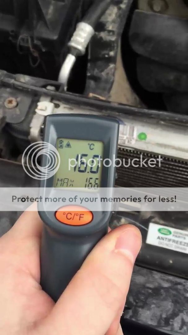

UPDATE:
Infra-red thermometer seems to have found the problem:
http://vid1340.photobucket.com/albums/o736...fic4ja.mp4
significant portion of the radiator is stone cold
Will have to clear out the gunk Cheers, David

However when I tested the temp of the radiator with the IR thermometer, I had just (<2min ago) parked up with the temp reading 95 degrees (hence thermostat presumably fully open). The hoses are all red hot and the heater was pouring out hot air.
The radiator wouldn't have had time to cool down on one half only and around 1/3 of the area was at a good temperature.
To me this has to be reduced operational area of the radiator due to some kind of blockage? Cheers, David

Well yes obviously I wouldn't expect it to get up to 90 odd, but around 1/3 of the rad was at 60-70 then the temperature falls off a cliff down to 16 over around a couple of centimetres.
That doesn't look to me like a gradient of steady cooling across the radiator but no water passing through due to blockage? Cheers, David
