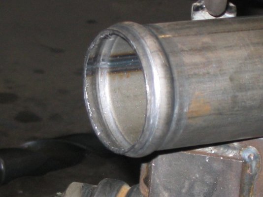

Are the tubes the hoses connect to fitted with beads? If not this could be the best answer, irrespective of which type of hose you fit.

Supacat, the pipe entering the the intercooler seemed to be plastic, with small ridges rather than a large bead like your pic.
Interesting that it's not unknown. Maybe not entirely the dealer's fault that it popped off then - more like poor design of the intercooler inlet or something. I wonder if glueing a bigger bead onto the pipe might be an option, along with a second jubilee clip. Wonder if I could fit 3 clips on there.
