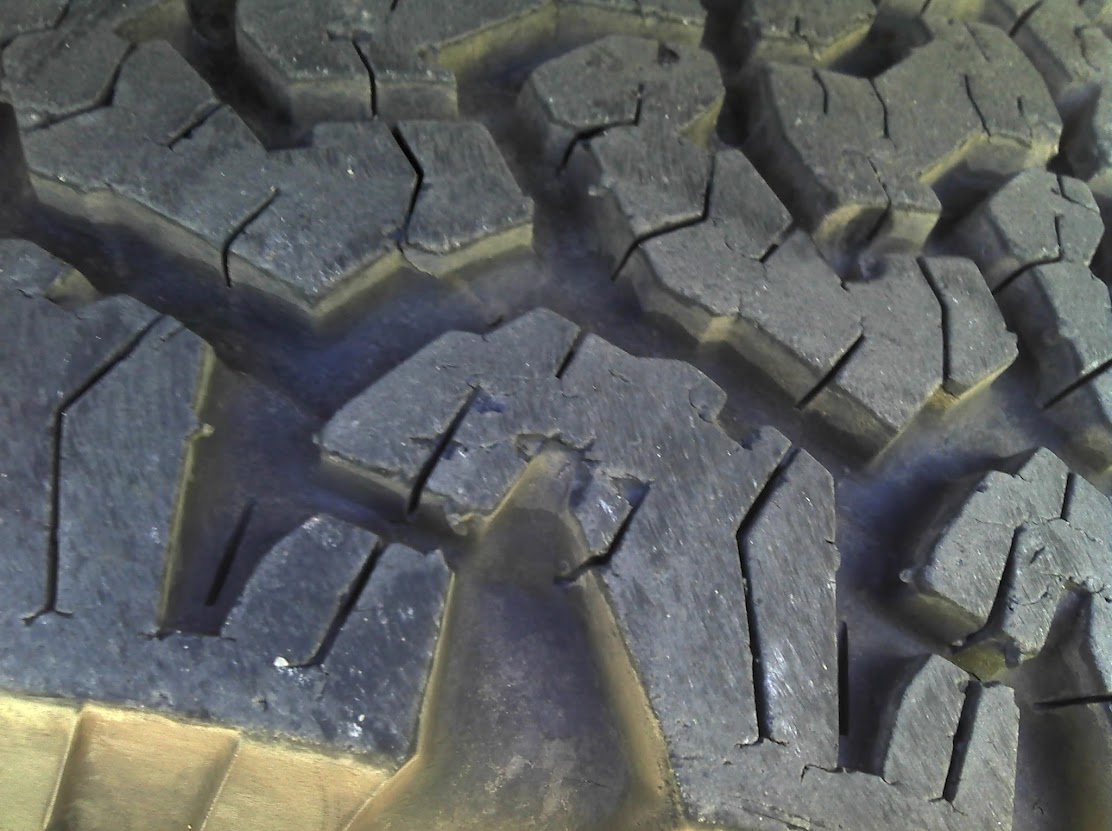

yeah, they are prone to do this. Puma owners seem to be the most affected, probably due to the TC.
Puma owners in the Western Cape are most prone to encounter this due to the gravel roads and type of 4x4 trails common in the area.
On our last club outing, the tyres on my landy looked like they'd been attacked by a pack of starving rats. Sad --
Post #224437 3rd Apr 2013 9:02pm
jst
Member Since: 14 Jan 2008
Location: Taunton
Posts: 7695
this s tarmac use, they have done about 40miles off road tops and that was Feb the last time. cracks appeared last couple of days. Cheers
James
110 XS Utility
130 Puma Station wagon/camper (in the making)
90 Puma Hardtop
Post #224441 3rd Apr 2013 9:22pm
Naks
Member Since: 27 Jan 2009
Location: Stellenbosch, ZA
Posts: 2597
this is what mine are starting to look like. these pics were taken before that trail where they got chewed up.
Similar to you guys, 99% of my driving is on tar.
