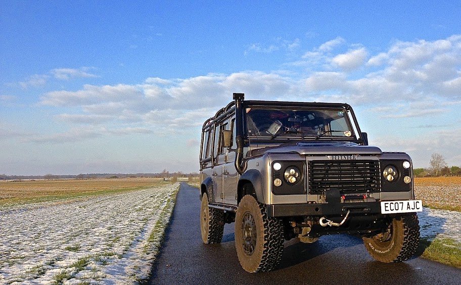

A few pictures from Malta:
A little surprise when I went out this morning, seems my Defender made friends overnight Very Happy

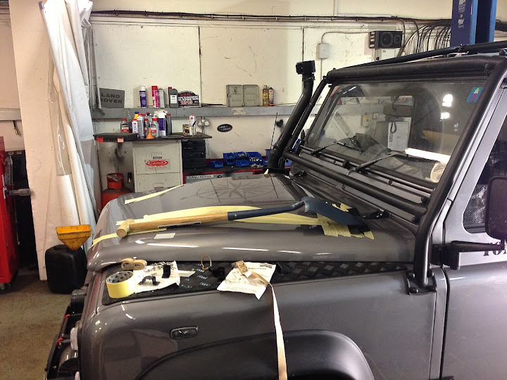

Decided to get a high lift jack
Progress photo, notice new snorkel head

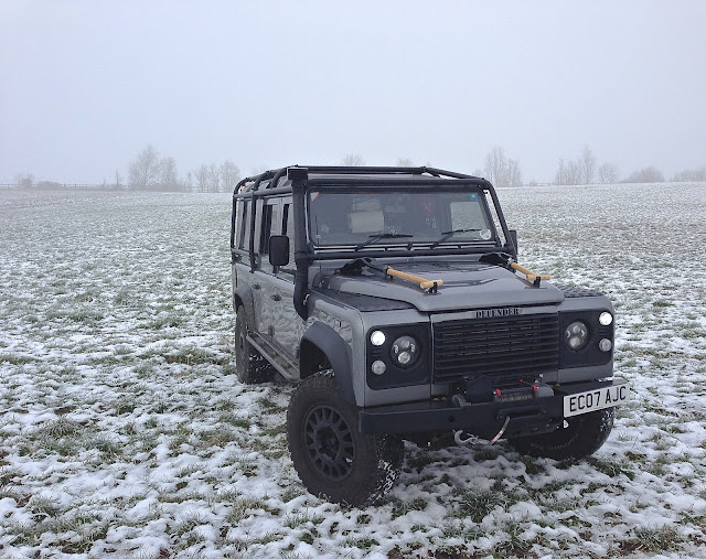

Decided to throw on some shovels..

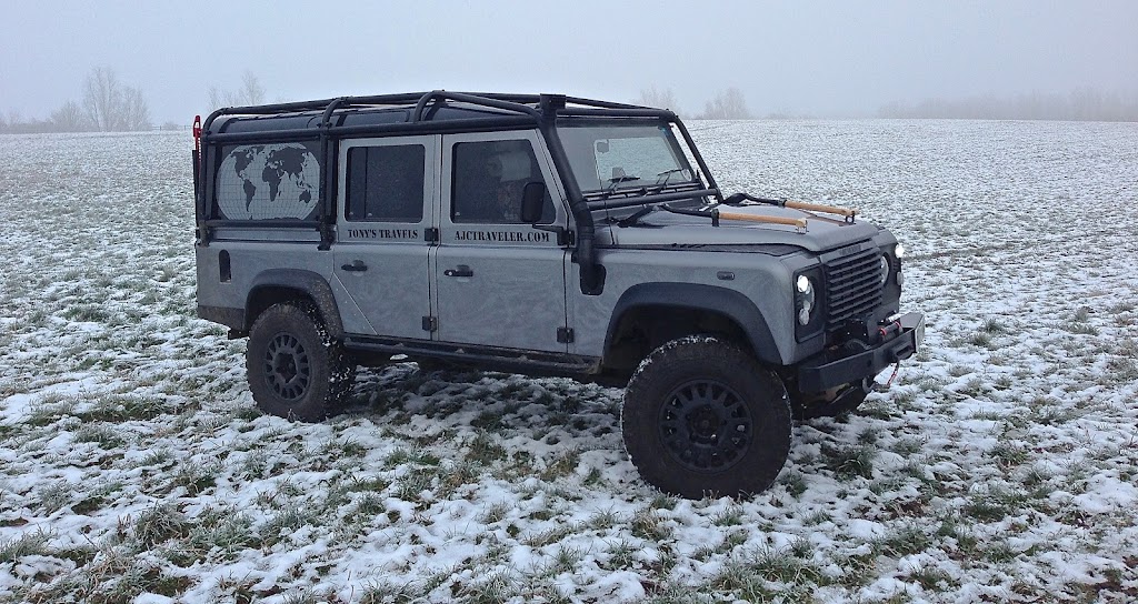

Went out to play in the snow a bit:

Youve probably already thought of this...
Are you planning to put a cover on the jack? If not, you may want to consider buying one, especially as you are going to Africa. The grease on the pins picks up dust and sand and then jams just when you don't need it, so a cover helps. Also a wheel adapter for the hi-lift is a useful bit of kit. 5 mins with a hi-lift and sand/bridging ladders can save 30 min + of digging, even though you are probably dying to use your new spades Wink Wink
Do you have a bottle jack too? If not, these are a good investment. Hi-lift are great for recovery, but not so good for changing a wheel.
Lastly, are you taking some spare shocks? if not, given weight of a loaded 110, taking some spares would be a good idea.
Oh and one more Q, is there a reason why you didn't go for the clear LED stop/tail lights too instead of red lenses?
Cheers and have fun on trip
Steve

The two shovels are really just for symmetry if Im honest. Also potentially someone can help me dig if need be.
