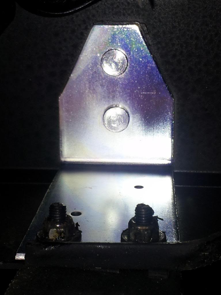

Well just had mine done on Friday and after having a look underneath they have added / changed a substantial metal plate that bolts to the floor and chassis rear outriggers. I,m not sure if the bolt sizes have increased, but there was a bit of swarf floating around the floor afterwards indicating the floor holes have been enlarged.
They also seem to have added some rubber pads between the outrigger and the new bracket.
I'm not sure if the previous plate conected to the outrigger or not, maybe somebody who has not had it done could say.
it took the garage about 20 minutes in all to complete the work.
I did take a pic but my old mac doesn't seem to want to allow me to upload it !
However the link below should take you to photobucket:
https://s3-eu-west-2.amazonaws.com/i.hubnu...46e46c.jpg
