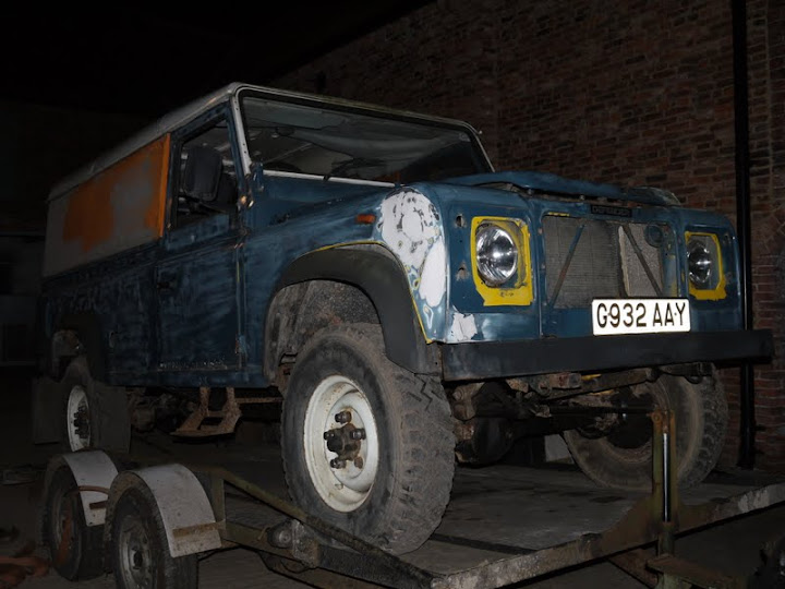

So having been out of the the green oval fold since early january I gave in and bought myself a project, a G reg 200TDi Ex Ambulance:
It was too good a deal to miss and only 6miles down the road from me!
It was purchased as a project by the previous owner following an LPG related V8 fault which drove the previous previous owner to sell it, the V8 was removed and a 75k mile 200TDi dropped it, since then it has sat unused since 2007.
The good bits: All transmission/Engine are in great order with minimal rust on axles and a sound rear salisbury. Tub is straight, as are all doors and OS wing. Most of the chassis is in great nick too! NS Footwell has been replaced as has nearside bulkhead outrigger

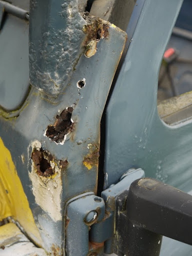

The Bad Bits: Bulkhead top corners are rotten, OS Footwell is rotten as is outrigger (someone got bored i think!!), NS Wing was filled with about 5litres of filler (seriously!)

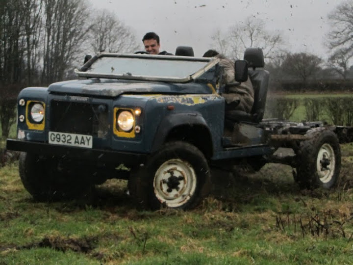

So since buying it 3days ago I have removed the roof and the tub and given it a good ahem 'test' (code for booted it around a field!)
All seems well and since stripping the tub I have found the chassis to be in fantastic condition which is a massive relief, next is wings off and then to replace the bulkhead outrigger (spare came with the car) then bulkhead off and replace driverside footwell (again replacement came with the car!)

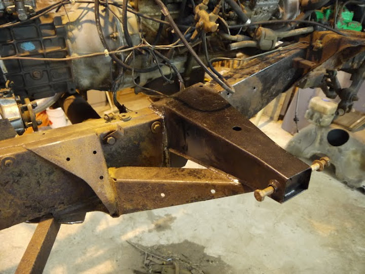

I've also started on the few rust patches, first the bulkhead outrigger and chassis beneath were removed:
Just need to get some plates cut and welded then this goes somewhere around here:
Found another patch of rust here:
so another plate required, but otherwise the chassis is looking good, nearly time to whip out the wire cup and take the rust off before more red oxide and chassis paint and shultz!

Plated the hole in the chassis underneath the bulkhead outrigger and then welded the outrigger into place:
Bearing in mind I haven't done any welding in 4 years I was happy with the results (any criticism/advice welcome):

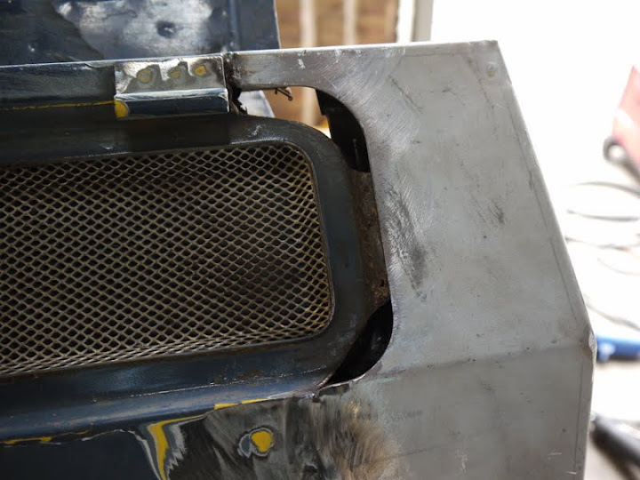

Managed to make a start on the bulkhead too:
Most of this would not have been possible without the purchase of a 2lt BOC Argoshield bottle, these are fantastic value (£35ish) i think and are a million times better than the disposable bottles that i was trying to use!

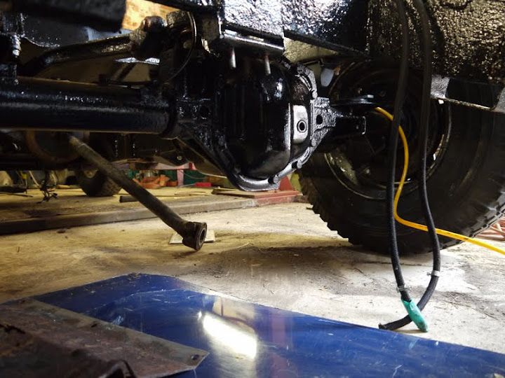

After treating the whole chassis and both axles with neutrarust, they were all painted with red oxide (no pics...sorry) and then painted with 2 coats of tractol chassis black:
Once that was done and reassembled with new bushes EVERYWHERE I moved on to the very rotten bulkhead today, some YRM repair panels that came with the 110 and then a load of bits of steel and half a bottle of welding gas led to this:
