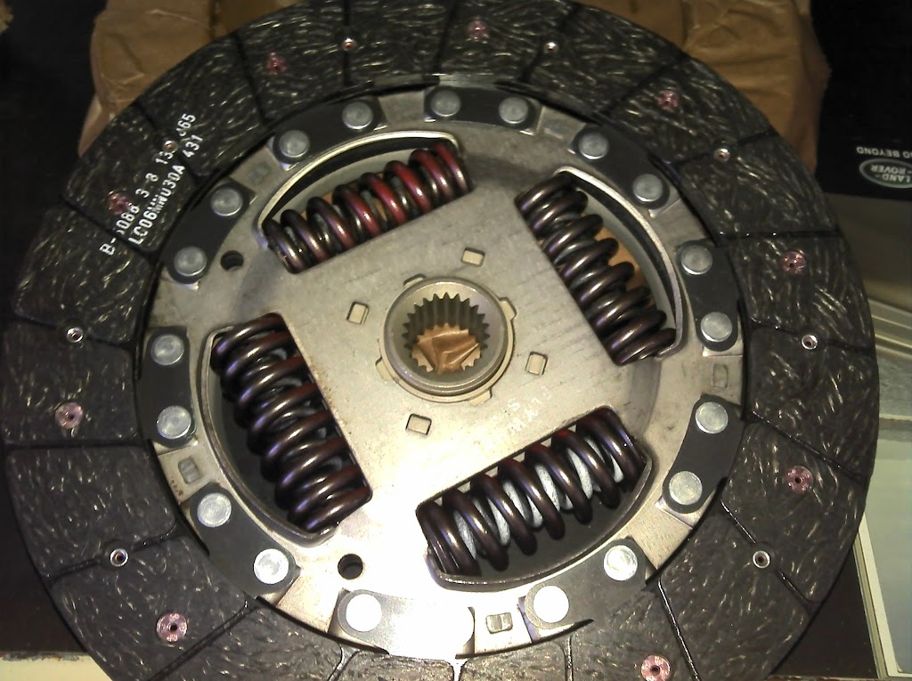

Seems to be 2nd type. Let us know how the replacement looks like. Puma 110" SW
Post #149146 8th Jun 2012 11:00am
Naks
Member Since: 27 Jan 2009
Location: Stellenbosch, ZA
Posts: 2684
I counted 9 coils in the springs, is that right? --

That is the "new" type with "white" teflon!

there are 3 types. Puma 110" SW

This is the clutch that is going in, looks the same to me:

Did it rattle like the last one?

Still in the box, they are putting it in this afternoon.
I will report back once I get the landy back. --
Looks like 3rd type. All plates rattle a bit. Iīm not sure why but might be a design issue in order to get some free play due to the Censored flywheel which cannot absorb some turning kicks of the cycle. Puma 110" SW
How can you tell? --

less coil turns and more separated. Or maybe is something between 2nd and 3rd Laughing
DIdnīt get worse since you fit the lift? Puma 110" SW
Now that you mention it, it does look like there are only 8 coils per spring.
I honestly don't think so --
